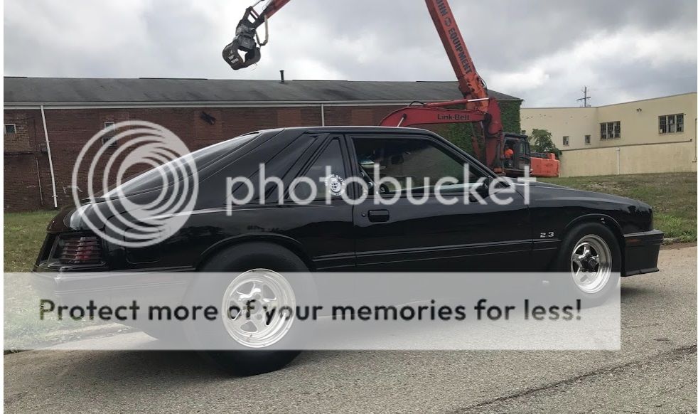

    Quote Originally Posted by martin0660 View Post
    Thanks. It takes better pictures than it really is. Paint is wonderful but starting to show it’s age
    Those Photos in full. So everyone gets them at a glance!
