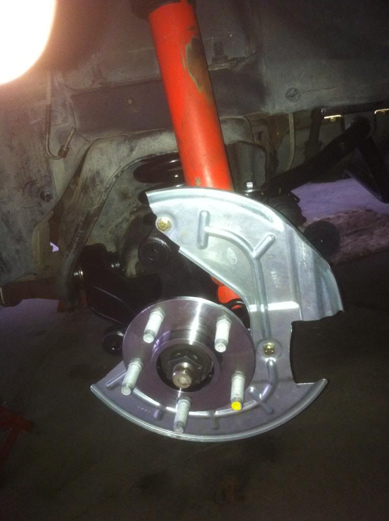

    I started by removing all of the front suspension: calipers, spindles, struts, swaybar and end links. I wasn't going to, but I decided to pull the control arms and change the bushings while I was this far in already.
    I bead blasted everything and painted with "Roll Bar and Chassis" paint. Those spindles in the pic are the newer 94 ones.

    Default 06-26-2013 Front Dust Shields
    I had read a bit about these not really being required and many don't use them. These new ones came installed on the '03 Mach 1 spindles that I wasn't using. I drilled the rivets out but I had no way of riveting these on myself. I decided to use some 1/4" short bolts with lock washers to secure them. Oh and new Timkin wheel hubs Got them much cheaper than retail through one of our industrial bearing suppliers at work. Special order from them but a decent price.
