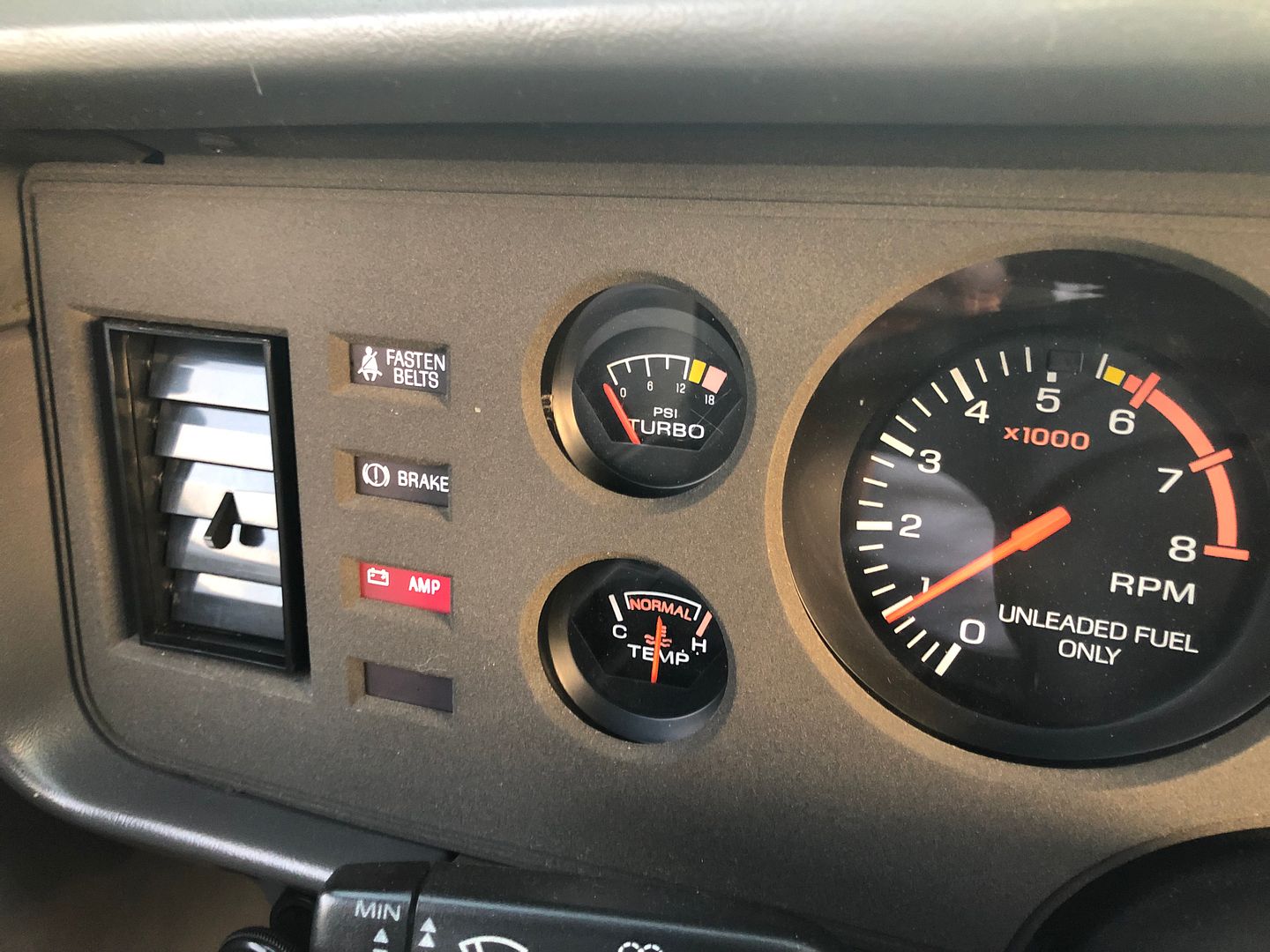

    Default Coolant sender.
    Quote Originally Posted by 82GTforME View Post
    As usual, I have been gathering needed parts over time to eventually get to one day.
    On the list:
    - Coolant temp sensor. Coolant gauge temperature seems inaccurate to the actual temp and fan on point.
    It's funny. I had to look around to find the sensor. As stated, I had questioned the fan operation and temperature switch in relation to the gauge reading. A couple of summers ago, I had got into slow freeway traffic on a warm afternoon and noted the gauge creeping up and making me nervous. I had tried to check the fan operation and only knew that it at least would come on. I just wasn't happy with what the gauge said when it did.
    Amazing how many different ones of these things there are to buy on the market. Different colours, temps etc. I found the right one at least
    I had noted last year after storage that I had a small coolant leak but I could not find it. While underneath and doing the cleaning I did I noted a drip on the started and found the turbo coolant return hose was the culprit!
    What a tough place to reach too! Good thing I can get in there other wise the starter and maybe more would have to come off!
    I drained the coolant and pulled the sensor. Filled it and fired it back up again to test.
    I let it run until the fan came on. Temps were reasonable with the infrared gun and the gauge read this when it kicked in. Before I had seen it creep to the line at least. Another small task done
