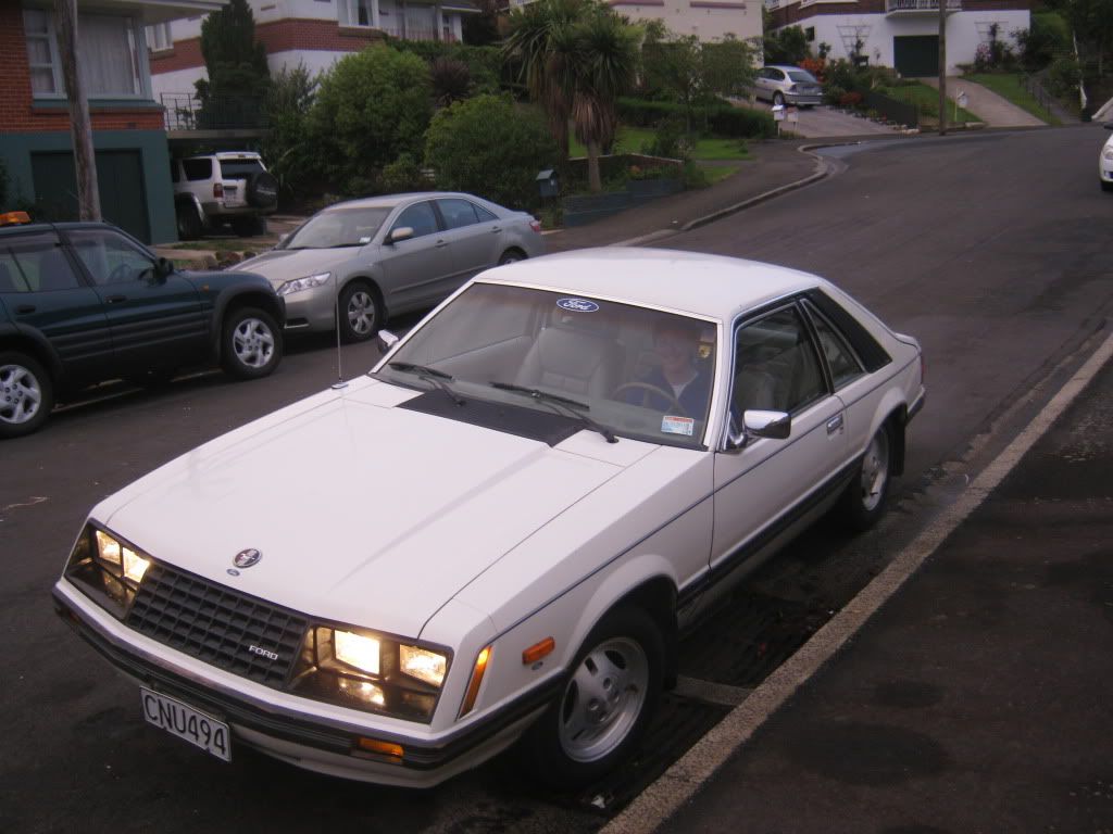

    ITZOLD, my Mustang should be a notchback but its a hatchback, coded as a P10 on the vin number as a Notch.
    I've run a New Zealand CARJAM report on ITZOLD to secure it perported history.
    "The vehicle has been re-registered — de-registered in the past and then registered again.
    Odometer readings are inconsistent and jump backwards sometimes. Possible reasons could include: entry error at an inspection time or border check, or around the clock, or a wound-back odometer. Odometer readings are incorrect? You maybe able to fix it".
    The original US Market www.getvin.com report I ran showed vin1FABP10B4CF109967 was an Original order Oct 28 1981, no concers, but no km history, it was exported to Japan but no reference to this.
    Neither show up any problems, although it lookes like someone tried to convert the odometers km reading into milesduring one bi annual inspection.
    I have a 1982 VIN 1FABP10B4CF109967 Mustang, but it is wrongly registered as a 1983 ex Japanese Domestic Market (JDM) car.
    It was built in Dearborn. Since 1990, its been in New Zealand (that funny group of islands below Tasmania, Australia).( Its full of JDM stuff, the Special Vehicle Engineering fold back door mirrors seen on British and German , Dutch and French market Mustangs, speed chimes that kick in at 100 km/h on the Canadian speedo, front repeater lights, yellow inspection paint on all the chassis bolts, grey stickers in Japanese on the fuel filler, valve cover and other areas. Std rear window wiper, tilt wheel, power steering windows and brakes, intermittent wipe, AM/FM stereo, laminated glass, rear window heater, heavy duty battery and TRX wheels and tires).
    Engine is BR101037, but again the NZ rego authorities have made a mistake, and its on the rego papers as BR101031
    Detail is Stamp2, DateO116Y, Small Code 2J213, Engine No BR101037

    No, its missing the door post decal, and thats the awkward part. So are the build sheets and it really makes removal of the front end clip manadatory before I go any further. Any useless to the cause info is there, like the tire placard, but no door post tag. Go figure...
    As you can see, there are some shut line inacuracies, with the rear edge of the passenger door instepped about 60 thou of an inch, but without going over it with a cover meter, I've no proof of what parts are from what Stang.
    The Fox Mustang is just like my old 'family hack' 250 cubic Inch 1984 XE Falcon GL sedan...the whole front clip comes off in one piece if you have help, so that's my only next option.
    I've got to use the vehicle for Road Inspections this week, so unless my son can remove the front clip over the next few days, FEP won't get the numbers till mid week at the very earliest.

    Today I finally replaced the 11A1195 A/C fan belts with shorter 11A1015 non A/C fanbelts as a provisional measure after a previous driver sh99ed the FoMoCo York compressor itself due to not having enough oil in it.
    At the same time, my son Ashley (Ash) did a partial strip out of the front part of the bumper and guards. Due to the fact that I have to use the car at night for auditing and road roughness, I can't remove any of the wiring or lights to get the guards clear of the inner catwalks where the buck codes sit. If mu lights are out of adjustment, I could have some issues with the validity of my reports, or find myself liable if my lights are not working or not factory functional while conducting a Night Drive-over.
    After a little discussion with Ash, we got Moms vanity mirror, cleaned it up with some Windoline, and took a few snaps with my A495 Canon. We have a big 42" screen for State Highway Auditing, and we got this to look blow the image up after we first flipped the image and rotated it 180 degrees.
    Good news is thew whole vehicle is uniform. The buck code is indeed R101037, exactly the same as engine number. Great to know team!
    Buck code same on both sides. So the tendered VIN no on the dash is not the same as the body and engine. Hence I've got to find the actual VIN with its proper sequence number, and search that for my Marti Report, as well as the tenderd VIN number. Since the engine number and buck code aggree, I've got to go back to Vehicle Identification New Zealand, and update them on the correct engine number, and find evidence that the VIN numbers were changed at some stage from two independent sources.
    Normally this is done by IVS (Independent Verification Services Limited), and the details matched when imports arrive in New Zealand, but for some reason, perhaps due to the non invasive nature of New Zealand inspections from 1990 to last year, the errors and requirements weren't resolved satisfactorily. I've worked with these guys and normally, the cars just sit untill the situation is resolved. If it isn't, the vehicle can potentially be send back to the country of origin.

    Wink Its a JDM 1981 Mustang Hatch...legit!!!!
    P15BR101037 9D
    BV A H JPN
    L P U 1B
    15R
    Care of my son. Well, what did you expect, that wrong VIN on the dash says 1982Dearborn, and I was looking for a buck code in the wrong place, that didn't even exist. And just one minute looking after FoxChassis got me sorted while I was under the charcol canister, we found it just sitting there. Snap!!!!
    You couldn't wipe the smile off my dial with an crow bar.

    Thanks for posting the buck tag. This is the first ever that I have seen with a "JPN" (exported to Japan, I presume) code. In the upper right coner of that tag (obscured in the pic you posted) is the original paint color.
    P15BR101037 = [see VIN decode above]
    BV = 3.3L I6 engine (B), C-3 transmission? (V)
    A = air conditioner
    H
    JPN = Japan? (exported to Japan)
    L
    P
    U
    1B
    15R = [combination of body codes "15" (VIN) and "61R" (door tag)]

    Charmed with your help!
    I'll take the tag off and see what the paint code is soon as I can figure out how TerryMWalsh did this in his SJ Capri BM. As soon as you reminded me that it was an R car, I instantly thought of my Aussie bro looking up over the vac canister for the said buck code mount. Felt like a real ding bat after I saw it sparkling in the air like the stars of orions belt. What a plonker I was to wait almost 2 years because I thought it was a Dearborn, Mich build and got frustrated that I couldn't find that non existant Dearborn tag. I also remember one other British person with a rhd SVE altered Cobra or Indy Pace car (1980 registration) that had the same battle, but he found it too. It's okay, not everyone has crawled to the depths of the knowledge tree like you have, FoxChassis.
    Trans is my beloved C3, lookes like its got the Variable Reluctor electronic speedo kit, which I've used for my Brantz meter, but may have been a stock cruise control item. The brake light and lots of little wiring reworks look like it may have had cruise control or at least an extensive alarm system. My mechanic works on Mustangs, including a version of Dick Johnstons Green No 17 1984 Fox 5.0 GT, and he says although original in spec, its had a lot of defects streaming from non standard replacement parts in the wiring, indicative of it being something of an orphan in Japan.
    I'm sure your aware of the 100 or so RHD Mustangs Ford of Britains Special Vehicle Engineering did on the Type Approved Export Foxes. One thing I noticed when I saw it on the lot in Dunedin in November 2010 was those UK Type approval /TUV T5 things were included (fold back door mirrors are the standard SVE Ford jiggle up with Fox Thunderbird remote but Euro Taunus/Cortina/Granada mirrors married together). It missed out on the Mark III Capri rear lights (which were needed for European endosed backup and fog light requirements; JIS standards allow stock US lights as long as the light pattern is reversed. Mine had a mixture of Koyoto and Stanley headlamps, and really bad wiring which is why I wasn't keen on dropping the whole front end). Most UK SVE modified Mustangs were I6's with C4's from what I can tell. J.D.M. cars of American extraction were quite okay being LHD in RHD Japan...it was a sign of pretentious according to what I've heard.
    It's also got Canadian speedo and 100km/h chimes and an oxygen sensor.
